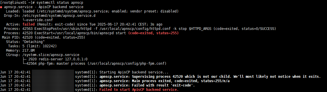

apiscp.service doesnt start
Description
The apiscp.service does not start, thus the web interface is not reachable. It always complains about “supervising a process that is not our child” before immediately exiting.
Expected Behavior
Apiscp runs without a problem
Actual Behavior
Additional Information
I already updated everything with upcp -a and restarted the server, but to no avail.
