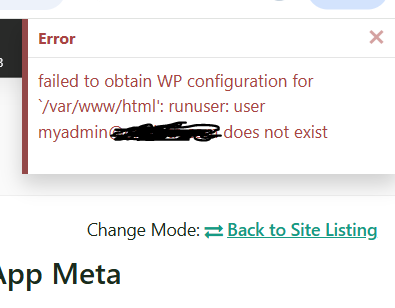

'failed to obtain WP configuration' Error
When I click the Wordpress ‘App’ in a site my Nexus dashboard, I get this error:
failed to obtain WP configuration for `/var/www/html’: runuser: user admin@[redacted].com does not exist

  • Can you reproduce this bug reliably? Provide steps. If not, provide steps to the best of your recollection.
    Yes, across many sites. Login to site, click the app, Error. Nothing on the App page loads correctly.
