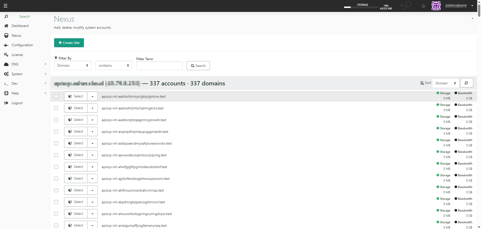

Thank you. I ran the command and it completed. It appears the log is still going, though.
It sent me an email that it was complete, but there are tons of accounts… something’s still not right.
Yes, those test accounts failed to cleanup because D-Bus was generating a segfault upon shutdown.
This should clean them up:
cd /home/virtual
DeleteDomain --force apiscp-int-*
