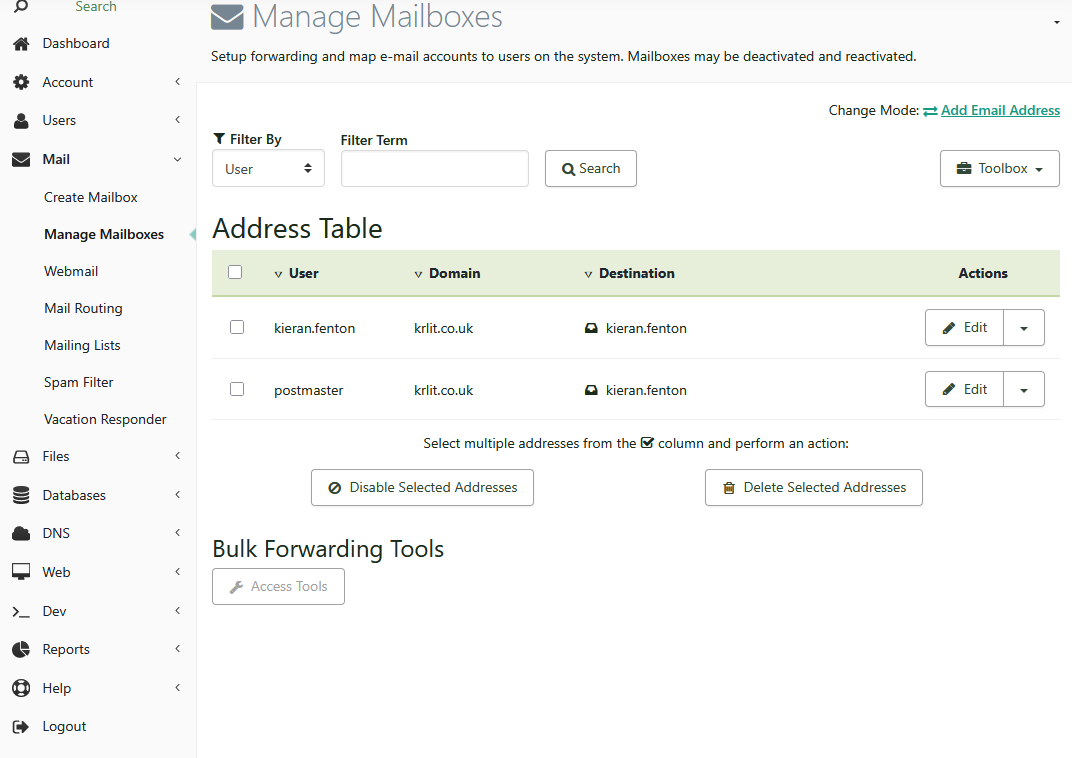

What does the entry under Mail > Manage Mailboxes look like for this email address? What does the corresponding system user look like in User > Manage Users?

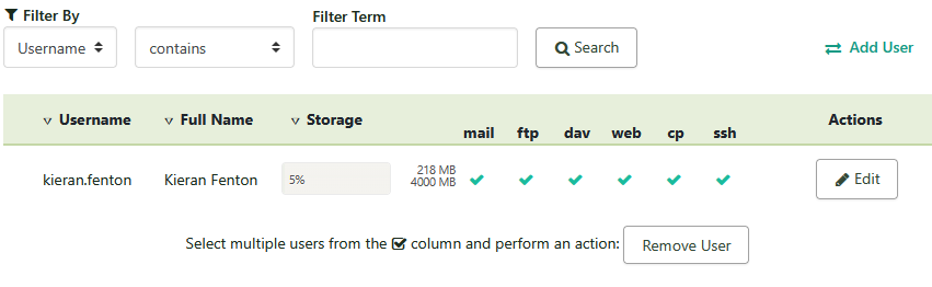

Please see the screenshots below. I have removed support as that wasnt working, and attempted it for my own user.
Still experiencing the same issue. Not getting emails and bounceback will eventually say user doesnt exist.
