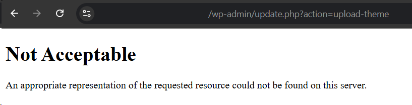

After standard WordPress install (on latest ApisCP, of latest WordPress) and releasing Fortification, theme upload/install fails after a couple minutes with HTTP error 406 - Not Acceptable:
Not Acceptable
An appropriate representation of the requested resource could not be found on this server.
Error log (/var/log/httpd/error_log) shows ClamAV triggered on zip:
[Fri Jan 30 12:39:54.562387 2026] [security2:error] [pid 1585561:tid 1585613] [remote <CLIENT-IP-REDACT>:49672] ModSecurity: [clamdscan scanner message: /tmp/20260130-123825-aX0WwRKVZ-tO_v8pb19kEgAAgRE-file-m2Bi7J: Sanesecurity.Foxhole.JS_Zip_17.UNOFFICIAL FOUND\n]\n [hostname "redacted.example.com"] [uri "/wp-admin/update.php"] [unique_id "aX0WwRKVZ-tO_v8pb19kEgAAgRE"], referer: https://redacted.example.com/wp-admin/theme-install.php?browse=popular
[Fri Jan 30 12:39:54.562413 2026] [security2:error] [pid 1585561:tid 1585613] [remote <CLIENT-IP-REDACT>:49672] ModSecurity: Access denied with code 406 (phase 2). Virus Detected [file "/etc/httpd/modsecurity.d/activated_rules/clamav-10.conf"] [line "5"] [id "1010101"] [msg "Malicious
File Attachment"] [severity "ALERT"] [hostname "redacted.example.com"] [uri "/wp-admin/update.php"] [unique_id "aX0WwRKVZ-tO_v8pb19kEgAAgRE"], referer: https://redacted.example.com/wp-admin/theme-install.php?browse=popular
