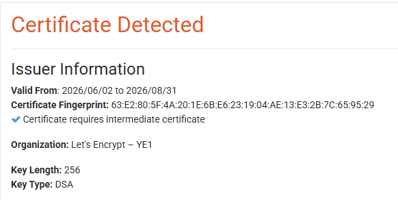

I’m now rate limited and was forced to manual install.
cpcmd -d site1 ssl:install "$PRIVKEY" "$LEAF" "$INTERMEDIATE"
I was able to sort the Certs into the leaf, intermediate and root and drop the root.
The certs translated to:
  • api.lithium.hosting (leaf), issued by Let’s Encrypt YE1
  • Root YE (intermediate), issued by ISRG Root X2
  • YE1 (intermediate), issued by Root YE
I can’t test for a few days until the rate limit is lifted. I can confirm the issue persists with the remote servers not able to validate the certificate.

API server needs to send “Root YE” cross-signed certificate in addition to the intermediate YE1 certificate. This PEM is:

One follow-on for anyone whose certs were already issued from the Gen-Y hierarchy (anything issued after the May-13 default-profile switch): letsencrypt:renew refuses them, so the fixed chain never gets applied. On a site whose installed cert is YE1/YE2/YR2:
# cpcmd -d <site> letsencrypt:renew
WARNING: Module\Support\Letsencrypt::getSanFromCertificate(): Rejecting certificate.
         Authority fingerprint `BB:20:CA:47:0B:FE:D7:E5:9C:F9:8F:09:2A:A3:8C:37:45:B1:BC:D8'
         does not match acceptable values
WARNING: Letsencrypt_Module::renew(): Certificate is not Let's Encrypt
getSanFromCertificate() reads the current cert to recover its SAN set, but the authority-fingerprint allowlist it validates against doesn’t include the Gen-Y intermediates — so renew decides the cert “is not Let’s Encrypt” and aborts. It works fine for hosts whose existing cert is still pre-Gen-Y (E-/R-series); it only trips when the installed cert is itself already Gen-Y.
Workaround: issue a fresh order instead of renewing — it bypasses the renew-side authority check and pulls the corrected chain:
cpcmd -d <site> letsencrypt:request '[example.com,*.example.com]'
# panel / server cert:
cpcmd letsencrypt:request '[<hostname>]'
I’ve added support for direct reissue of any certificates issued by YE1 that lack the YR cross-sign certificate.
Run upcp then cpcmd -d siteXX letsencrypt:renew for any affected account.
