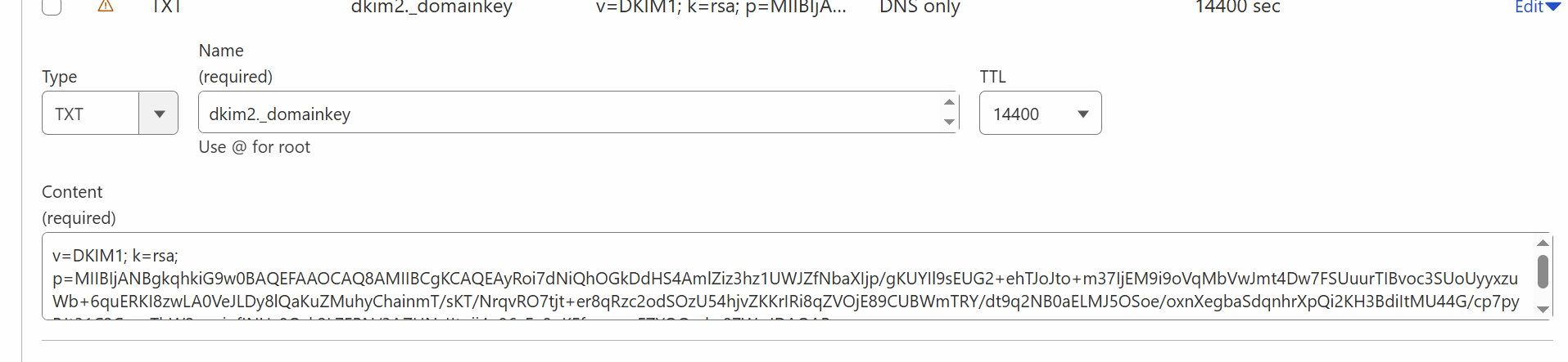

Key is contiguous in Cloudflare’s dashboard.

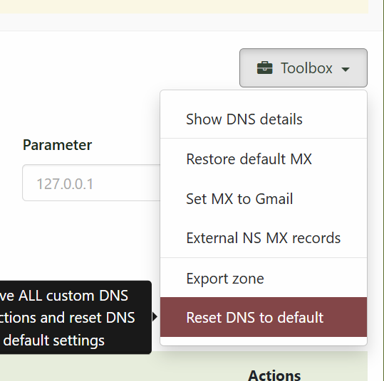

If the domain exists and [dns] => migrate is disabled (default), then it’s necessary to reset DNS. This can be accomplished with cpcmd -d DOMAIN dns:reset DOMAIN to clean all existing records + import base records. It’s also available within the UI under DNS > DNS Manager > Toolbox > Reset DNS.
